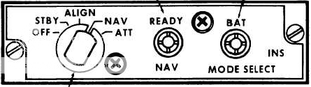

For this tutorial purpose, I will only explain how to "align" the INS, I won't go into detail on how to load the waypoints into the INS. Place the INS Mode Selector to "STBY"
On the INS, place the selector knob to "POS" and insert you're current latitude (press the number 8 which will give you South), once the latitude is correctly displayed, press "INSERT". Do the same for the longitude (press 6 for East).
When done with inserting the coordinates, place the INS Mode Selector switch to "ALIGN"
You can see the progress of the INS by placing the INS selector knob to DSRTK/STS. Let the INS countdown all the way to 05.

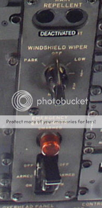

On the right side of the overhead panel switch all "Window Heat" switches to "on".
Once the INS has counted down to 05, place the INS Mode Selector to NAV. Do not taxi out without the INS Mode Selector in the NAV position, this will render the INS useless for navigation and it can be used for Attitude Reference only.

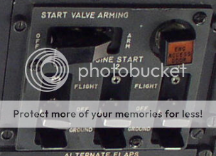

On the overhead panel, select the "start valve arm" to arm and place the Number 1 Start Switch to "Ground"
Observe the drop in duct pressure on the Flight Engineers panel:
After the starter has engaged and the duct pressure has dropped we should see an increase in N2 RPM and on the Flight Engineers panel we should observe a rise in oil pressure:
At 15-18% N2, move the Start Lever to the Start Position, monitor the Fuel Flow (max 500Kg/h) and check that the start temperature (EGT) does not exceed 575ºC. At 35% N2 release the start switch and observe the rise in duct pressure again.

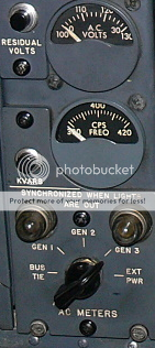

After all three engines have successfully started, position the AC Meter on the Flight Engineers panel to "GEN1". Observe 115VAC and 400HZ with the amber flashing lights going on and off (not alternating left and right, both go on and off)
We will now parallel the number 2 and 3 generator against the number 1 generator. Close the Number 1 Generator Breaker and position the AC Meter to Gen 2, again observe 115VAC/400HZ. When the sync lights are out, close the number 2 Generator Breaker. Position the AC Meter to Gen 3 and again close its Generator Breaker when the sync lights are out.
When all 3 generators are paralleled, place the Essential power selector to "Gen 3" and leave it there.
